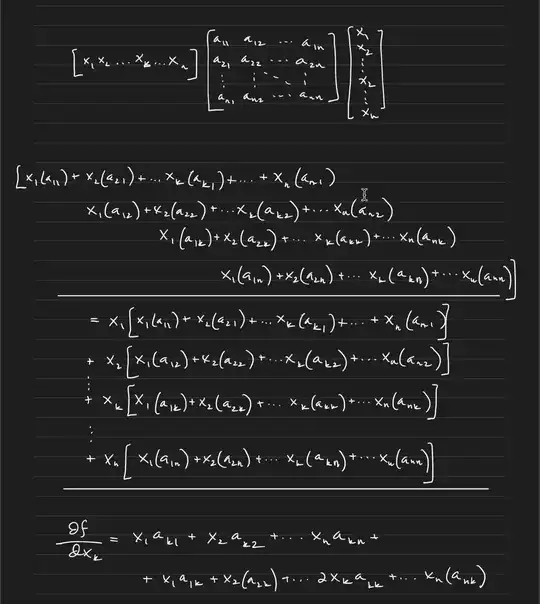

Edit: My work and the way I did it enter image description here

  • @ancientmathematician ya part of the problem set is proving why we can make that assumption. We assume A is not symmetric and define $ B = (A' + A)/2 $. B is symmetric and after simplification is the same as the original A. I'm going to include a screenshot of my work in an edit above. I believe it is the same as the answer, but please let me know otherwise. – aisync Apr 24 '21 at 07:16

  • @aisync Now that I see your working I'd say this: learn to use the summation notation. Your working is full of "dot dot dot" which means "make a good guess at what I have missed out"; the summation notation is precise. It may not matter in easy cases, but it can lead to serious problems. – ancient mathematician Apr 24 '21 at 09:28
