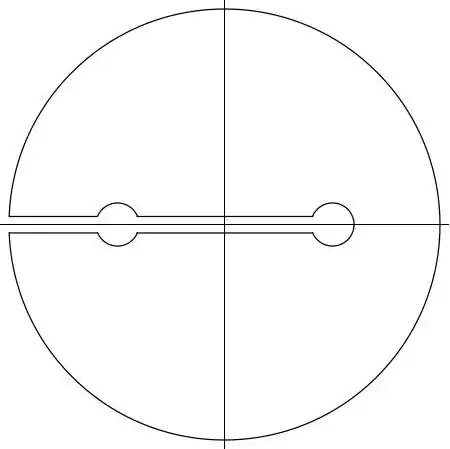

Actually, this integral is very straightforward to evaluate using Cauchy's Theorem in the complex plane.
Consider the complex integral
$$\oint_C dz \, \log^3{\left (\frac{z+1}{z-1} \right )} $$
where $C$ is the following contour in the complex plane:
The outer arc of $C$ has a radius $R$ and the small circular pieces around the branch points at $z=\pm 1$ have radius $\epsilon$. The contour integral is then equal to
$$e^{i \pi} \int_R^{1+\epsilon} dx \, \log^3{\left (\frac{x-1}{x+1} \right )} + i \epsilon \int_{\pi}^0 dx \, e^{i \phi} \, \log^3{\left (\frac{-1+\epsilon e^{i \phi}+1}{-1+\epsilon e^{i \phi}-1} \right )} \\ + \int_{-1+\epsilon}^{1-\epsilon} dx \, \left [\log{\left (\frac{1+x}{1-x} \right )} -i \pi\right ]^3 + i \epsilon \int_{\pi}^{-\pi} d\phi \, e^{i \phi} \, \log^3{\left (\frac{1+\epsilon e^{i \phi}+1}{1+\epsilon e^{i \phi}-1} \right )} \\ - \int_{-1+\epsilon}^{1-\epsilon} dx \, \left [\log{\left (\frac{1+x}{1-x} \right )} +i \pi \right ]^3 + i \epsilon \int_{2 \pi}^{\pi} dx \, e^{i \phi} \, \log^3{\left (\frac{-1+\epsilon e^{i \phi}+1}{-1+\epsilon e^{i \phi}-1} \right )} \\ - e^{-i \pi} \int_R^{1+\epsilon} dx \, \log^3{\left (\frac{x-1}{x+1} \right )} + i R \int_{-\pi}^{\pi} d\theta \, e^{i \theta} \, \log^3{\left (\frac{R e^{i \theta}+1}{R e^{i \theta}-1} \right )} $$
As $\epsilon \to 0$ and $R \to \infty$, all integrals vanish or cancel except the third and fifth; the contour integral is then equal to
$$\int_{-1}^1 dx \, \left \{\left [\log{\left (\frac{1+x}{1-x} \right )} -i \pi\right ]^3 -\left [\log{\left (\frac{1+x}{1-x} \right )} +i \pi\right ]^3 \right \} $$
By Cauchy's Theorem, the contour integral is equal to zero. Expanding the integrand, we immediately determine the value of the integral without further computation, because the cube and linear powers of the log cancel. That is, we are left with the log squared term sought, and a constant term that is trivially dealt with. The result is, using symmetry of an even function:
$$\int_0^1 dx \, \log^2{\left (\frac{1+x}{1-x} \right )} = \frac{\pi^2}{3}$$
