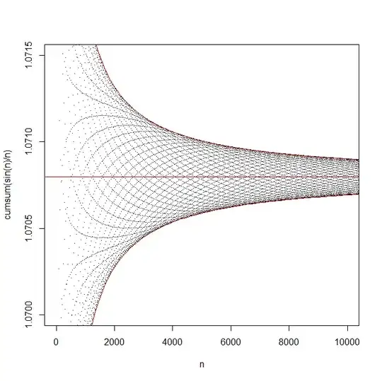

Empirically, it seems to be bounded by about $\frac12(\pi-1) \pm \frac{1.043}{n}$, as shown in the chart below.
What is the precise value of this $1.043$ term?

\sum\limits_{k=1}^n \frac{\sin(n)}{n}
created in R with
n <- 1:11000
plot(n, cumsum(sin(n)/n), ylim=c(1.07,1.0715), xlim=c(1,10000), pch=46)
abline(h=(pi-1)/2, col="red")
curve((pi-1)/2 + 1.043/x, from=1, to=max(n), add=TRUE, col="red")
curve((pi-1)/2 - 1.043/x, from=1, to=max(n), add=TRUE, col="red")

Note that $\displaystyle\left|\sum_{k=1}^n \frac{\sin k}k - \frac12(\pi-1)\right| = \left|\sum_{k=n+1}^\infty \frac{\sin k}k \right|$.
We prove the following inequality:
$$ \left|\sum_{k=n+1}^\infty \frac{\sin k}k \right| \leq \frac{1}{2 \sin(\frac 12)} \frac 1{n+1} + \frac{3}{4\sin^2(\frac 12)} \frac 1{(n+1)(n+2)} $$

This is a summary of my comments to Gabriel Romon's answer, which gave
$= \left|\frac{\cos(n+\frac 12)}{2 \sin(\frac 12)} \frac 1{n+1} + \frac{\sin(n+1)-\sin (1)}{4\sin^2(\frac 12)} \frac 1{(n+1)(n+2)} -\frac{1}{2 \sin^2(\frac 12)} \sum\limits_{k=n+1}^\infty \frac{\sin(k+1)-\sin(1)}{k(k+1)(k+2)} \right|.$
By the triangle inequality this is
$\le \left|\frac{\cos(n+\frac 12)}{2 \sin(\frac 12)} \frac 1{n+1} + \frac{\sin(n+1)}{4\sin^2(\frac 12)} \frac 1{(n+1)(n+2)}\right| +\left|-\frac{\sin (1)}{4\sin^2(\frac 12)} \frac 1{(n+1)(n+2)} -\frac{1}{2 \sin^2(\frac 12)} \sum\limits_{k=n+1}^\infty \frac{\sin(k+1)-\sin(1)}{k(k+1)(k+2)} \right|.$
For the first part, $\left|\cos(x+1/2) + b \sin(x+1)\right| < 1+ \frac34 b$ for $0 \lt b \le 1$, and $\frac{3/4}{2\sin(1/2)}<4/5$, so $\left| \frac{\cos(n+\frac 12)}{2 \sin(\frac 12)} \frac 1{n+1} + \frac{\sin(n+1)}{4\sin^2(\frac 12)} \frac 1{(n+1)(n+2)} \right| < \frac{1}{2 \sin(\frac 12)} \frac 1{n+1} + \frac45 \frac{1}{2 \sin(\frac 12)} \frac 1{(n+1)(n+2)}$.
For the second part $\left|-\frac{\sin (1)}{4\sin^2(\frac 12)} \frac 1{(n+1)(n+2)} -\frac{1}{2 \sin^2(\frac 12)} \sum\limits_{k=n+1}^\infty \frac{\sin(k+1)-\sin(1)}{k(k+1)(k+2)}\right| = \left|\frac{1}{2 \sin^2(\frac 12)} \sum\limits_{k=n+1}^\infty \frac{\sin(k+1)}{k(k+1)(k+2)}\right|$ which is $\mathcal{O}(1/n^3)$, and smaller than $\frac15 \frac{1}{2 \sin(\frac 12)} \frac 1{(n+1)(n+2)}$ for $n>8$.
Adding these two parts gives an absolute difference less than $\frac{1}{2 \sin(\frac 12)}\left( \frac 1{n+1} + \frac 1{(n+1)(n+2)}\right) < \frac{1}{2 \sin(\frac 12)}\frac1n$ with the first eight terms checked to ensure they meet the overall bound.
Thus $$\left|\sum_{k=1}^n \frac{\sin k}k - \frac12(\pi-1)\right|< \frac1{2\sin(1/2)}\frac{1}{n}$$ where $\frac1{2\sin(1/2)}\approx 1.0429148214667441.$
As the first part hints, there are many values of $n$ for which the absolute difference exceeds $\frac1{2\sin(1/2)}\frac{1}{n+1}$, starting with $n=3,6,9,12,31,34,53,56,75,78,\ldots$, suggesting this is the tightest multiple of $\frac1n$.

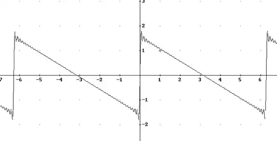

Comment: The value of this sum is indeed (pi-1)/2. This is confirmed by noting that the function f(x) = pi-x on (0, pi), extended oddly to (-pi, 0), and then extended to all real numbers periodically and with the usual convention, has Fourier series = sum(sin(nx)/n; n=1,2,...). The extended function is continuous except at integer multiples of pi. Hence, we have equality at x=1, so the sum in question = f(1) = (pi-1)/2.
For more details, see: Michael W. Ecker, Combining Mathematics and Technology to Sum Certain Series, Mathematics and Computer Education, Winter 2013, Vol. 47, No. 1, p. 19-23.
Graph of f and a partial sum of Fourier series
    That is a well known fact, as you know. The problem is about how fast the series converges for a pint within the domain of continuity. $x=1$ is just once example. The OP could have chosen $x=2$ and something similar (with a different constant in the bound $O(1/n)$ ) would have occur. – Mittens Apr 20 '21 at 18:45
