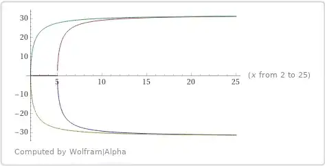

Choosen the arbitrary infinity contour $\;C\;$ with the points $\;z_1, z_2,\dots,\;$ one can get $$S_n=\sum\limits_{k=0}^\infty\left(\sqrt{k+1} - \sqrt k\right)^n = 1+\dfrac1{2\pi i}\oint\limits_C f_n(z)\text dz\tag4$$
In particular, for the contours $$C =\left\{\dfrac{1}{1-t^2}+p+32it,\;t\in(-1,1),\;p\in[1,4]\right\}$$ Contours of integratio
easily to get the integral representation in the form of $$S_n= 1+\dfrac1{2\pi i}\int\limits_{-1}^1 f_n\left(\dfrac{1}{1-t^2}+p +32it\right)\left(\dfrac{2t}{(1-t^2)^2}+32i\right)\text dt.\tag5$$
