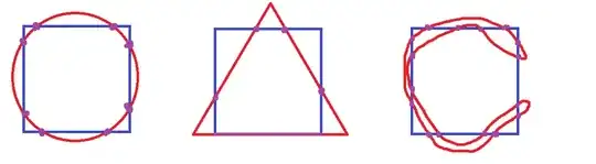

To phrase my question more clearly: Imagine you have a game with two players, Minnie and Maxime. Minnie starts by defining some closed curve. Then Maxime translates, rotates, and scales a square with the goal to maximize the number of intersections between the edges of the square and the curve. Minnie tries to think of a curve to minimize the number of intersections. Is it possible for Minnie to get a curve for which Maxime cannot transform the square to get at least 8 intersections?
For example Maxime will be able to get 8 intersections with a circle, an infinite amount with a triangle (overlapping straight edges) and 16 with some kind of croissant shaped closed curve.
A circle can intersect the square up to 9 times. A triangle an infinite amount when it has an overlapping edge. The third closed curve can intersect the square 16 times.
    What about a very eccentric ellipse? – themaker Apr 08 '21 at 13:41
    @themaker I was thinking that too but you can put a small square in the middle such that the corners poke out but not the side – MIO Apr 08 '21 at 13:46
    Reminds of the https://en.wikipedia.org/wiki/Inscribed_square_problem, which is still open. – Ivan Neretin Apr 08 '21 at 14:02
  • This would actually solve this but it's unfortunately (as you stated) open – Aryan Apr 08 '21 at 15:05
    @aldodecristo You're right. Sneaky squares! – themaker Apr 08 '21 at 15:48

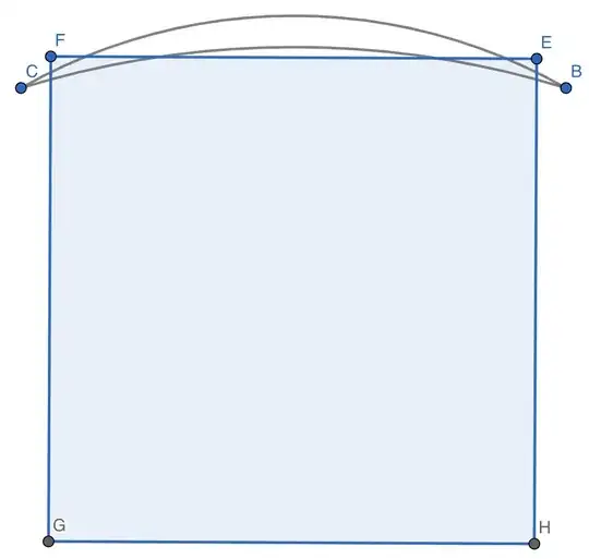

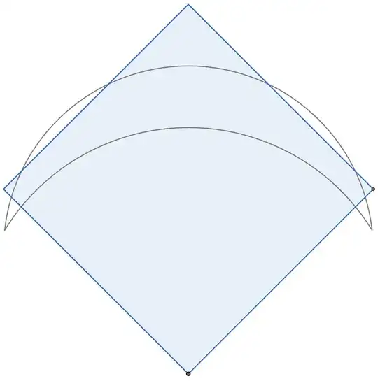

This isn't an answer, but I need to post a picture in order to demonstrate that the crescent idea doesn't work. See the following:
This handles the case where the upper arc subtends more than $\pi/2$ radians. And in the "sufficiently flat" case, we have:
which I think is quite interesting since one side has zero intersections but the opposite side makes up for this by having four. I think this is a key configuration that demonstrates that any non-convex shape admits a line that intersects the boundary at four distinct points.

  • If the crescent shape is sufficiently flat, then I believe you are correct; however, for the particular crescent you have drawn, a square can be drawn such that two sides each intersect the upper arc twice, and the other two sides each intersect the upper arc once and the lower arc once. By "sufficiently flat," I think this can be quantified as saying that the upper arc cannot subtend an angle of more than $\pi/2$ radians. – heropup Apr 26 '21 at 04:21
  • Personally, this answer and your arguement @heropup don't convince me, but I also do not know if you both are incorrect. But even if either of you are correct, the proof of the claim seems to be harder than finding a counterexample shape – QC_QAOA Apr 26 '21 at 04:38
  • @QC_QAOA I found another configuration that admits 8 intersection points for any crescent, unfortunately, so the crescent idea doesn't work. – heropup Apr 26 '21 at 04:44
