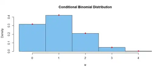

  • Hints: (a) $S = X + Y \sim \mathsf{Pois}(\lambda_1+\lambda_2).$ (b) $P(X=x|S=u) = $ $\frac{P(X=x,S=u)}{P(S=u)}=$ $\frac{P(X=x,Y=u-x)}{P(S=u)} =$ $\cdots$ $ {u\choose x}p^x(1-p)^{u-x},$ where $u > x, p = \frac{\lambda_1}{\lambda_1+\lambda_2}.$ – BruceET Apr 04 '21 at 17:35
Comment continuted: Simulation in R for $\lambda_1 = 1; \lambda_2 = 3, u = 4.$
lam.1 = 1;  lam.2 = 3,  u = 4
p = lam.1/(lam.1+lam.2)
set.seed(404)
x = rpois(10^6, lam.1)
y = rpois(10^6, lam.2)
s = x + y
w = x[s ==u]      # [ ] denotes conditioning
mean(w); var(w)
 [1] 1.000098     # aprx E(W) = up = 4(1/4) - 1
 [1] 0.7502605    # aprx Var = 3/4
hdr = "Conditional Binomial Distribution" hist(w, prob=T, br=(0:5)-.5,col="skyblue2", main=hdr) k = 0:4; pdf = dbinom(k, 4, p) points(k, pdf, pch=19, col="red")
