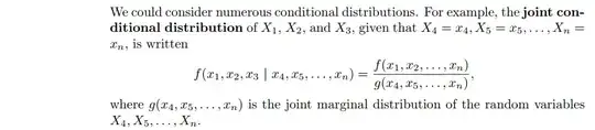

Found in Larsen and Marx
  • unfortunately this is for discrete. it seems there's no mention of a continuous BUT THEN there's an exercise THAT ASSUMES a definition for continuous.
Also found in
Walpole, Myers, Myers and Ye
  • I believe it applies for both continuous and discrete.
