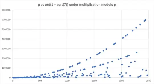

I noticed the order of $1 + \sqrt 7$ in my group is usually of the form $\frac{p^2 - 1}{d}$ where $d$ is some positive integer divisor.
For example, operating under mod $p := 5$: $5^2 - 1 = 24$ and $\mathrm{ord}\left(1 + \sqrt 7\right) = 12 = 24/2$.
I plotted the order of $1 + \sqrt 7$ under different values of $p$ and here are the results: enter image description here You can easily see the patterns emerge (i.e. broken parabolas in the plot):
  • $p^2 - 1$
  • $(p^2 - 1)/2$
  • etc.
Why does this happen? Is there a reliable way to predict when this happens and even what the divisor would be? This could potentially provide an efficient way to calculate the order of my group element.
