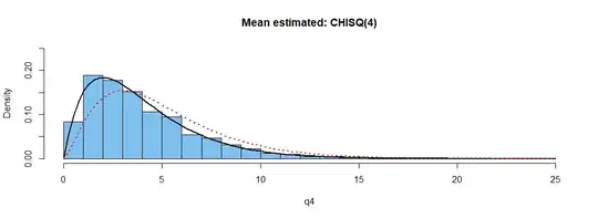

Simulation in R: Population mean estimated by sample mean.
set.seed(2021)
n = 5;  mu = 100;  sg = 15
q4 = replicate(n^5, 4*var(rnorm(n,mu,sg))/sg^2)
mean(q4)
[1] 4.000032  # aprx mean of CHISQ(4) = 4.
In the figure below the density function of $\mathsf{Chisq}(\nu=4)$ fits the simulated values, while the density function of $\mathsf{Chisq}(\nu=5)$ does not.
hdr = "Mean estimated: CHISQ(4)"
hist(q4, prob=T, br=20, ylim=c(0,.25), col="skyblue2", main=hdr)
 curve(dchisq(x,4), add=T, lwd=2)
 curve(dchisq(x,5), add=T, lwd=2, col="red", lty="dotted")

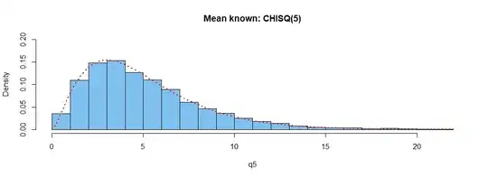

Population mean known:
set.seed(320)
q5 = replicate(n^5, sum((rnorm(n,mu,sg)-mu)^2)/sg^2)
mean(q5)
[1] 5.109602  # aprx mean of CHISQ(5) = 5
hdr = "Mean known: CHISQ(5)"
hist(q5, prob=T, br=20, ylim=c(0,.20), col="skyblue2", main=hdr)
