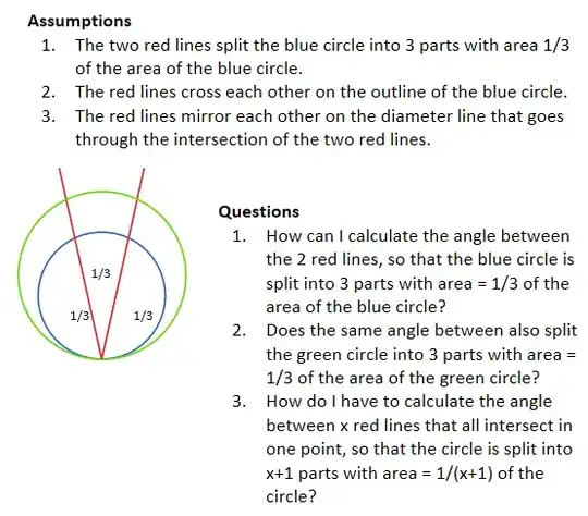

The picture probably explains my question best.
I need to find a way to divide a circle into 3 parts of equal area with only 2 lines that intersect each other on the outline of the circle.
Also I need to check, if whatever diameter is between those lines, also splits circles with a different diameter into equal parts.
And lastly, and probably the most difficult question: How do I have to calculate the angle between x lines that all intersect in one point, so that the circle is split into x+1 parts with area = 1/(x+1) of the circle?
I tried my best, but couldn't even find a single answer or the right strategy to tackle the question...
- Yes. If you find the red lines so that they divide the blue circle into 3 parts of equal areas, then the green circle is also dividd into 3 equal parts.
– CiaPan Mar 18 '21 at 20:58

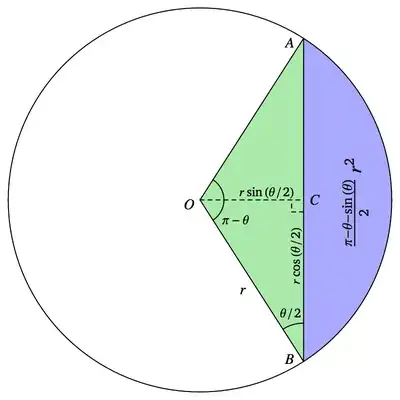

Given the angle $\theta$, split by the diameter containing $B$, consider the following diagram:
$\overline{BO}$ is the line through the center and $\overline{BA}$ is the chord cutting off the lune whose area we wish to compute.
The area of the circular wedge subtended by $\angle BOA$ is $$ \frac{\pi-\theta}2r^2\tag1 $$ The area of $\triangle BOA$ is $$ \frac12\cdot\overbrace{r\sin\left(\frac\theta2\right)}^\text{altitude}\cdot\overbrace{2r\cos\left(\frac\theta2\right)}^\text{base}=\frac{\sin(\theta)}2r^2\tag2 $$ Therefore, the area of the lune is $(1)$ minus $(2)$: $$ \frac{\pi-\theta-\sin(\theta)}2r^2\tag3 $$ To get the area divided into thirds, we want $$ \frac{\pi-\theta-\sin(\theta)}2r^2=\frac\pi3r^2\tag4 $$ which means we want to solve $$ \theta+\sin(\theta)=\frac\pi3\tag5 $$ whose solution can be achieved numerically (e.g. use $M=\frac\pi3$ and $\varepsilon=-1$ in this answer) $$ \theta=0.5362669789888906\tag6 $$ Giving us
Numerical Details
The iteration from this answer, applied to $\theta+\sin(\theta)=\frac\pi3$, is $$ \theta_{n+1}=\frac{\pi/3-\sin(\theta_n)+\theta_n\cos(\theta_n)}{1+\cos(\theta_n)}\tag7 $$ Here is the result of this iteration starting at $0$; $$ \begin{array}{l|l} n&\theta_n\\\hline 0&0\\ 1&0.5\color{#AAA}{23598775598298873077107230547}\\ 2&0.5362\color{#AAA}{45321326153808318904236597}\\ 3&0.5362669789\color{#AAA}{24456230942633093381}\\ 4&0.53626697898889055276\color{#AAA}{1878717471}\\ 5&0.53626697898889055276244906787\\ 6&0.53626697898889055276244906787 \end{array} $$
- 345,667
If you mean the area $\frac{\pi-\theta}2r^2$ in $(1)$, that is because $\angle BOA=\pi-\theta$, and the area of a sector with angle $\alpha$ of a circle with radius $r$ is $\frac\alpha2r^2$. – robjohn Oct 28 '23 at 10:32
