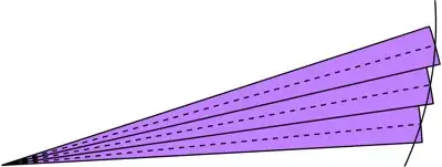

There are at least two way to look at this formula. The simplest, in my opinion, is approximating the area inside the arc into small circular arcs.
$\hspace{3.5cm}$enter image description here
The area inside each arc of radius $r$ and angle $\Delta\theta$ is $\frac12r^2\Delta\theta$ (this is proportional to $\pi r^2$ for the entire circle). Summing these approximations as $\Delta\theta\to0$ yields $$ \int\frac12r^2\mathrm{d}\theta $$
Another approach is to look at the Jacobian of the conversion from rectangular to polar coordinates. $$ \mbox{ $\begin{align} x&=r\cos(\theta)\\ y&=r\sin(\theta) \end{align} $} \quad\text{and}\quad \mbox{$ \begin{align} \mathrm{d}x&=\cos(\theta)\,\mathrm{d}r-r\sin(\theta)\,\mathrm{d}\theta\\ \mathrm{d}y&=\sin(\theta)\,\mathrm{d}r+r\cos(\theta)\,\mathrm{d}\theta \end{align} $} $$ That is $$ \begin{bmatrix}\mathrm{d}x\\\mathrm{d}y\end{bmatrix} =\begin{bmatrix}\cos(\theta)&-r\sin(\theta)\\\sin(\theta)&r\cos(\theta)\end{bmatrix} \begin{bmatrix}\mathrm{d}r\\\mathrm{d}\theta\end{bmatrix} $$ The determinant of the Jacobian yields $$ \begin{align} \mathrm{d}x\,\mathrm{d}y &=r(\cos^2(\theta)+\sin^2(\theta))\,\mathrm{d}r\,\mathrm{d}\theta\\ &=r\,\mathrm{d}r\,\mathrm{d}\theta \end{align} $$ if we integrate in $r$ from the origin first, this yields the area to be $$ \int\frac12r^2\,\mathrm{d}\theta $$

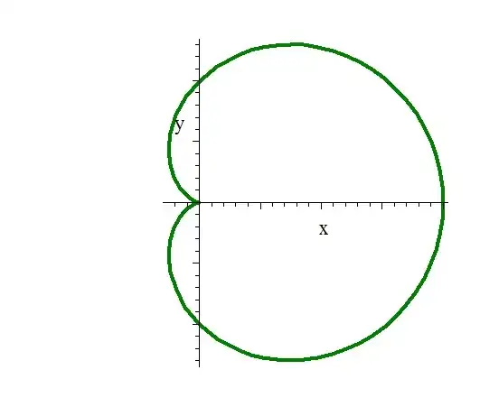

3. Area of a Cardioid. To compute the area of a cardioid with equation $r=4a\cos ^{2}\frac{\theta }{2}$ (see figure 2 below) we need to find the limits of integration. From the figure we see that $r\in [0,4a\cos ^{2}\frac{\theta }{2}]$ and $\theta\in[0,2\pi]$. The integral $(2)$ reduces to
$$\begin{eqnarray*} A_{\text{cardioid}}=\int_{0}^{2\pi }\left( \int_{0}^{4a\cos ^{2}\frac{\theta }{2}}r\ \mathrm{d} r\right)\ \mathrm{d}\theta &=&\int_{0}^{2\pi }\left( \left. \frac{r^{2}}{2}\right\vert _{0}^{4a\cos ^{2}\frac{\theta }{2}}\right)\ \mathrm{d}\theta\tag{$\ast\ast$} \\ &=&\int_{0}^{2\pi }\left( 8a^{2}\cos ^{4}\frac{\theta}{2} \right)\ \mathrm{d}\theta \\ &=&6\pi a^{2}. \end{eqnarray*}$$
Equation $(\ast\ast)$ corresponds to the formula in the question. Now $r$ is not constant, rather a function of $\theta$.
$$\text{Figure 2: cardioid }r=4a\cos ^{2}\frac{\theta }{2}$$
Added: The factor $r$ in $(2)$ is the Jacobian of the transformation. Here is an evaluation: $$\begin{eqnarray*} \frac{\partial \left( x,y\right) }{\partial \left( r,\theta \right) } &=&\det \begin{pmatrix} \partial x/\partial r & \partial x/\partial \theta \\ \partial y/\partial r & \partial y/\partial \theta \end{pmatrix} \\ &=&\det \begin{pmatrix} \cos \theta & -r\sin \theta \\ \sin \theta & r\cos \theta \end{pmatrix} \\ &=&r\cos ^{2}\theta +r\sin ^{2}\theta \\ &=&r. \end{eqnarray*}$$
