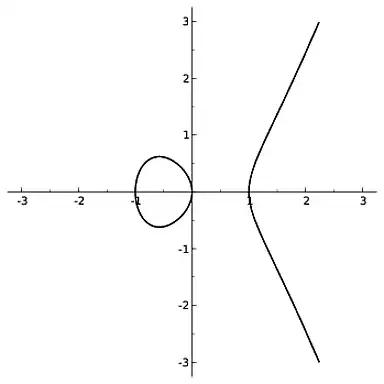

Basically it says that if the plane passes through the hole in the torus, then the real locus of the elliptic curve looks like the following
Elliptic Curve over the reals, with two components

The complex points of the elliptic curve lie in the projective plane over $\mathbb C$. Supposing that the coefficients of the elliptic curve are in $\mathbb R$, it then makes perfect sense to intersect the curve with the projective plane over $\mathbb R$. If we forget the point at infinity, then we can just think that we are intersecting a certain punctured torus in $\mathbb C^2$ with $\mathbb R^2$.
Of course, the torus is not embedded as neatly as in the picture you posted (or, more accurately, it is not so much a question of "neatness" of the embedding, but rather the fact that the torus is embedded holomorphically in $\mathbb C^2$, which as a real manifold is of dimension four), but the description of the intersection is nevertheless correct.
