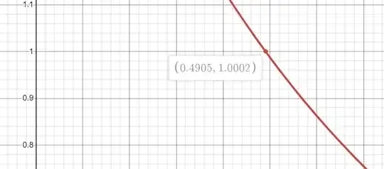

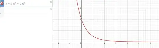

To start out with we can graph the LHS in a graphing cqalculator:
Clearly, the answer is somewhere close to $x \approx 0.5$ for $y=1$. (Specifically, close to $x = 0.49064).
