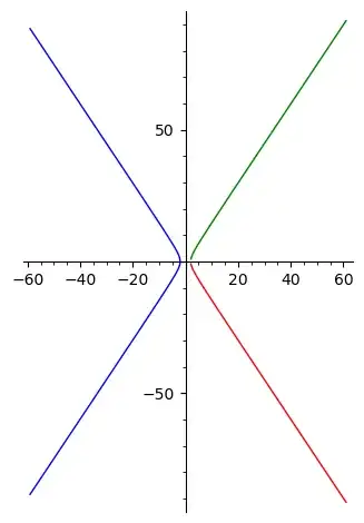

One of the roots is $x = a$ and since the constant term is the product of the roots, then the other is \begin{align*} x = -\frac{a (a^2 t^2 + b^2)}{b^2 - a^2 t^2} \end{align*} which, together with $$ y = t(x-a) = t\left(-\frac{a (a^2 t^2 + b^2)}{b^2 - a^2 t^2} - a\right) $$ gives a parametrization of the whole hyperbola, except for the point $(a,0)$. Note that since $b^2 - a^2 t^2 = (b - at)(b+at)$, then $x$ and $y$ have poles at $t = b/a$ and $t=-b/a$. Here's a SageMath cell plotting this parametrization, and the resulting plot with the ranges $t < -b/a$, $-b/a < t < b/a$, and $b/a < t$ colored differently.
$\hspace{4cm}$ enter image description here
