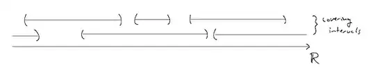

Again, there is a pretty intuitive observation about Euclidean space running around behind the scenes. Imagine trying to cover $\mathbb{R}$ by open intervals, and then throwing away as many sets as you can. What you will likely end up with is a collection of intervals which overlap "just a little" at their ends, see the figure.
No matter how gnarly the initial cover is, I can always find a way to "throw away" enough sets so that the remaining sets don't overlap too much. Specifically, no point on the real line will be contained in more than two of the covering intervals.
By contrast, if you attempt to cover the plane $\mathbb{R}^2$ by disks such that no point is contained in more than two disks, you will rapidly find that this is impossible—there must be some points contained in three disks.
