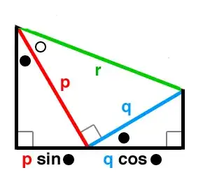

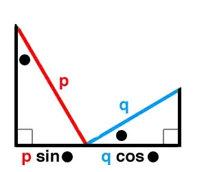

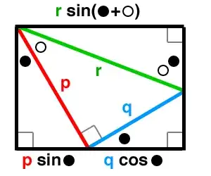

For the left-hand side, we'll need a right triangle with hypotenuse $p$ and one with hypotenuse $q$, each with an acute angle $\theta$. We want to arrange those triangles so that the leg opposite $\theta$ in the $p$-triangle and the leg adjacent to $\theta$ in the $q$-triangle make a straight segment that represents the sum of their lengths. Like so (with $\theta$ represented by a black dot, since I'm recycling an old image):
p sin + q cos
Looking to the right hand side's $r$, the Pythagorean relation $p^2+q^2=r^2$ suggests we need to show $r$ as the hypotenuse of a right triangle with legs $p$ and $q$. By interesting coincidence, the angle between the hypotenuses of our $p$-triangle and $q$-triangle is itself a right angle! (Why?) So, joining the other ends of these segments gives us $r$.
And r
In fact, we now also have $\phi$ (the white dot), since $q/p$ is clearly the "opposite-over-adjacent" ratio for the marked angle.

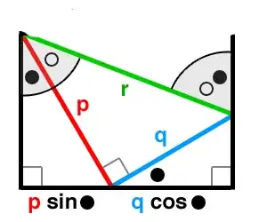

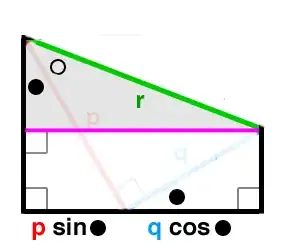

To complete the diagram, we need a right triangle with hypotenuse $r$ and acute angle $\theta+\phi$ (strategically placed so that the left-hand and right-hand sides of the identity are clearly equal). Well, we have a right triangle with hypotenuse $r$, but that's not good enough; the angles are wrong. Where can we see $\theta+\phi$ (the sum of the black dot and white dot)? Hmmm ... Look at the top-left corner of the diagram: we have an angle $\theta$ next to and angle $\phi$ ... together they make $\theta+\phi$; and, hey! They're right next to that segment $r$! If only we could make $r$ the hypotenuse of a right triangle with angle $\theta+\phi$.
That's easy: draw a perpendicular!

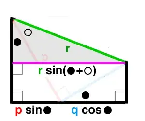

Then, then new (purple) segment opposite $\theta+\phi$ in a triangle with hypotenuse $r$; it must have length $r\;\sin(\theta+\phi)$.
Since the new segment is clearly congruent to the bottom segment (they're opposite sides of a rectangle), we've demonstrated that the parts of the trig identity are equal. Mission accomplished!
In point of fact, we can do a little bit better. It's not cool that the purple segment is obscuring other parts of the diagram. But how can we move it? We drew it because we needed a triangle with a $\theta+\phi$ in it; to move it, we'd need another angle like that ... oh, wait a minute ... Notice how the sides of the diagram are parallel (being perpendicular to a common segment)? and how that $r$ segment is their transversal? Hmmmm ...
Now we can draw another convenient ---and non-obscuring--- perpendicular to represent $r\;\sin(\theta+\phi)$.
And there you have a diagram of the identity $p\;\sin\theta + q\;\cos\theta = r\;\sin(\theta+\phi)$.

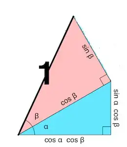

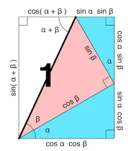

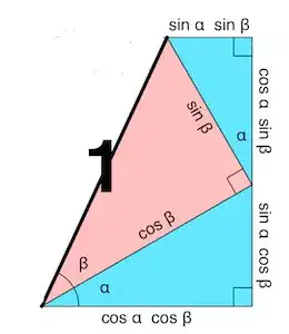

it takes a slight leap to know how to represent the component products. Take for instance, $\sin\alpha\;\cos\beta$. Is it a "$\text{this}\cdot\sin(\text{that})$" situation (with "this"$=\cos\beta$ and "that"$=\alpha$), or a "$\text{this}\cdot\cos(\text{that})$" situation? It could be either, but let's assume the former; that means we'd want our diagram to feature a right triangle with hypotenuse $\cos\beta$ and acute angle $\alpha$. But, to create our hypotenuse of length $\cos\beta$, we'll need it to be a leg adjacent to $\beta$ in a triangle with hypotenuse $1$: we must stack one triangle on top of another!
The good news is that the "other" leg in the (blue) triangle with hypotenuse $\cos\beta$ will have length $\cos\alpha\;\cos\beta$, which is convenient, because we'll need one of those. Oh, and hey ... The other leg in the (pink) triangle of hypotenuse $1$ has length $\sin\beta$, which could be the hypotenuse of a convenient new triangle with legs $\cos\alpha\;\sin\beta$ and $\sin\alpha\;\sin\beta$; we need those, too!
Conveniently, we find that we've created (at the bottom-left) the angle $\alpha+\beta$. As before, we can drop a simple perpendicular to bound that angle inside a triangle with hypotenuse $1$; but, as before, we can do a little better:

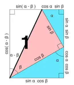

This gives us a (white) triangle with hypotenuse $1$ and legs $\sin(\alpha+\beta)$ and $\cos(\alpha+\beta)$, positioned in such a way that the sine segment is clearly the sum of the two vertical segments we constructed, and that the cosine segment is clearly difference of the horizontal segments.
With a very slight adjustment, we turn the diagram into an illustration of the angle-difference identities
$$\begin{align} \sin(\alpha-\beta) &= \sin\alpha\;\cos\beta - \cos\alpha\;\sin\beta \\ \cos(\alpha-\beta) &= \cos\alpha\;\cos\beta + \sin\alpha\;\sin\beta \end{align}$$

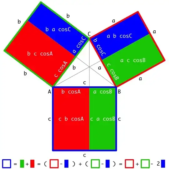

For instance, here's a simple picture-proof of the Law of Cosines, created using the diagramming strategies described here:
