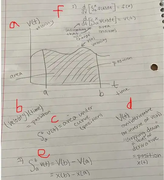

I am not sure that I am completely understanding FTC in terms of how the derivative and definite integral are connected. I drew/wrote this depiction of how I currently think they are connected in terms of velocity and position. I was wondering if anyone could point out any potential gaps in my understanding. enter image description here

    You need to be really careful because the following statement you made is incorrect: $\frac{d}{dt}\left[\int\limits_a^x v(t)dt\right] = v(t)$ because $\left[\int\limits_a^x v(t)dt\right]$ is a function of $x$, not $t$, so, in a since, the technically correct as is $0$ although the "more" technically correct answer is it's $v(x)\frac{dx}{dt}$. – Jared Jan 30 '21 at 00:28
  • I think it's often times very useful to completely write out FTOC when trying to use it, rather than attempting to remember the derivative rule. For instance: $\frac{d}{dt}\left[\int\limits_a^x v(t)dt\right] = \frac{d}{dt}\left(F(x) - F(a)\right)$ where, by FTOC, we know that $F'(x) = v(x)$. Thus when differentiating we employ the chain rule and say $\frac{d}{dt}F(x) = \frac{d}{dx}F(x)\cdot\frac{dx}{dt} = v(x)\frac{dx}{dt}$. – Jared Jan 30 '21 at 00:31

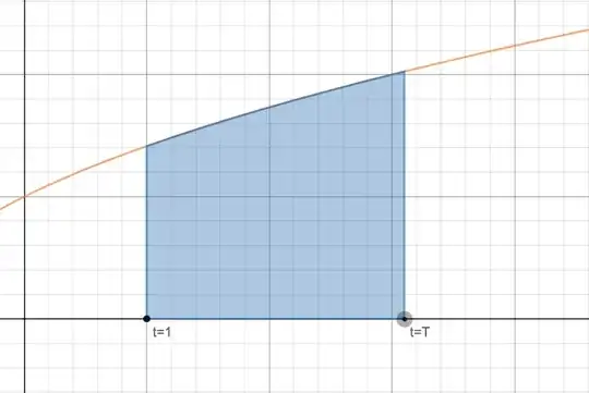

I'd say your geometric picture is a good start for understanding the fundamental theorems of calculus. (I say theorems because really there are two of them.) Say the velocity of a car that has been travelling for one second can be modelled by the equation $$ v(t)=\sqrt{t+1} \quad{1\leq t} \, , $$ The velocity-time graph looks like this:
Velocity-time graph
Since the horizontal axis represents time, and the vertical axis velocity, the area under the curve represents the $\text{velocity $\times$ time $=$ displacement}$ of the car. This means that the displacement of the car (from its position at $t=1$) after $T$ seconds is given by $$ \int_{1}^{T}v(t) \, dt = \int_{1}^{T} \sqrt{t+1} \, dt \, . $$ But we also know that the derivative with respect to time of displacement is the velocity, meaning that the antiderivative of velocity is displacement. That last sentence was a little sloppy: every function has infinitely many antiderivatives which differ by a constant. But we can use the information given in this example to narrow things down to one antiderivative: $$ s(t) = \int v(t)\, dt \, = \int \sqrt{t+1} \, dt = \frac{2}{3}\left(t+1\right)^{3/2}+C $$ When $t=1$, the displacement of the car is zero. Hence, $$ s(1) = 0 = \frac{2}{3}\left(t+1\right)^{3/2}+C \implies C = -\frac{2}{3}2^{3/2} \, , $$ meaning that $$ s(t) = \frac{2}{3}\left(t+1\right)^{3/2} - \frac{2}{3}2^{3/2} \, . $$ Hence, after $T$ seconds, the displacement is given by $$ s(T) = \frac{2}{3}\left(T+1\right)^{3/2} - \frac{2}{3}2^{3/2} $$ But we also know that $$ s(T) = \int_{1}^{T} \sqrt{t+1} \, dt \, $$ which gives us a clue as to how integrals and antiderivatives are related. In more general terms, $$ s(T) = \int_{1}^{T} v(t) \, dt = \int v(t) \, dt \bigg|_{t=T} $$ (Here, I'm using the notation $$ \int v(t) \, dt \bigg|_{t=T} $$ in a slightly unorthodox way, to refer to one particular antiderivative rather than many.) We are almost there: if we differentiate both sides of $$ \int_{1}^{T} v(t) \, dt = \int v(t) \, dt \bigg|_{t=T} \, , $$ we get $$ \frac{d}{dt}\int_{1}^{T} v(t) \, dt = v(T) \, , $$ which is the first fundamental theorem of calculus. We have at last discovered a concrete connection between integrals and antiderivatives. Again, there is a nice geometric interpretation. Recall that by definition, \begin{align} \frac{d}{dt}\int_{1}^{T} v(t) &= \lim_{\Delta t \to 0}\frac{\int_{1}^{T+\Delta t} v(t) \, dt-\int_{1}^{T} v(t) \, dt}{\Delta t} \\[6pt] &= \lim_{\Delta t \to 0}\frac{\int_{T}^{T+\Delta t}v(t) \, dt}{\Delta t} \, . \end{align} As $\Delta t$ shrinks towards zero, the area (marked in green below) $$ \int_{T}^{T+\Delta t}v(t) \, dt $$ is better and better approximated by the rectangle with width $\Delta t$ and height $v(T)$.
