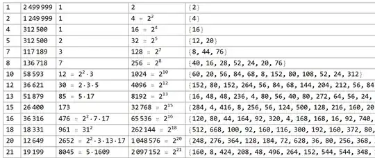

Per request, the reason I think I can show the above is based on the empirical results for $n<5\times 10^6$, which gives:
The leftmost column is $k$, the number of steps required to reach a smaller number. The fourth column, obviously going as $2^k$, is the period after which appearances of $k$ repeat. There are multiple appearances of a given $k$ within that period, e.g. for $k=5$ which shows up with alternating intervals of 12 and 20, but that's not required for my conjecture.
This pattern strikes me as regular enough that I suspect a good reason for it would not be hard to work out. Of course, I could be wrong about that, but my question is whether the rest of my logic makes sense assuming a proper proof for this part exists.
