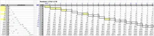

The following picture shows the primefactorization of $2^B-1$ in contrast to the values of $3^N \pmod {2^B}$, where for each $2^B$ the sequence of $3^k \; k=1..20$ is documented. The yellow marked entries show the solutions $N\in\{1,2,3\} \cup \{4,8,12\}$. Interesting that the periodicity for each $2^B$ over consecutive $3^k$ seems to be just $2^{B-2}$. Is there some hint in this?
