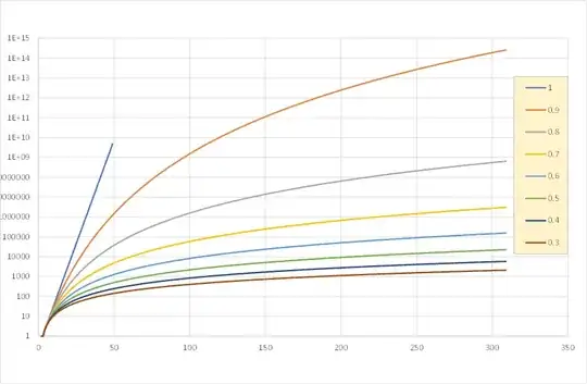

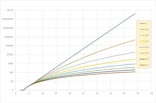

This modified sequence with $0<c<1$ grows at a rate somewhere between linear and exponential as illustrated by the graph of some values on a log-y scale:
The smaller the exponent, the less the increment will change at one step compared to the previous. The asymptotic behavior should tend towards (nearly) linear.
All such sequences start $0,1,1,2,3$ - the exponent has no effect applied to $0$ or $1$ of course.
