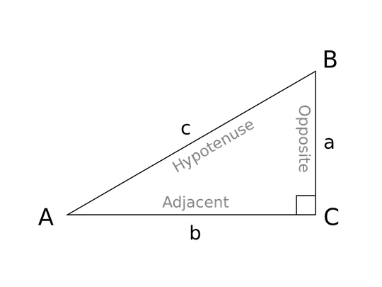

Consider a right angles triangle containing an angle A, as shown in the image below. enter image description here
We define the (basic) trigonometric functions as follows: $$\sin A=\frac{a}{c}=\frac{\text{Opposite}}{\text{Hypotenuse}}$$ $$\cos A=\frac{b}{c}=\frac{\text{Adjacent}}{\text{Hypotenuse}}$$ $$\tan A=\frac{a}{b}=\frac{\text{Opposite}}{\text{Adjacent}}$$
So in fact the trigonometric functions for a given angle give us the ratio of any two relevant sides of this right angled triangle. Note that because of similarity as discussed before this ratio is constant however large this right angled triangle is, as long as the angles are kept constant.
This definition cannot be extended to angles larger than $90$ degrees (or negative ones for that matter); if you want I could do this for you but it is more complicated.
