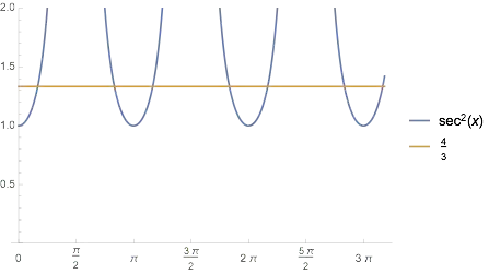

Sometimes a plot can really help:
WolframAlpha offers $2$ solutions here where
$$x = \pi n - \frac{5 \pi}{6}, n \in\mathbb{Z}$$
$$x = \pi n - \frac{\pi}{6}, n \in\mathbb{Z}$$
Your addition of $2n\pi$ is always a multiple of $360^\circ$ so the results would be the same but $\quad n\pi\quad$ would take you, for example from quadrant $(1)$ to quadrant $(3)$ where the $\sin$ and $\cos$ are both negative. In any case the $\sec^2$ would still be positive so a rotation of only $180^ \circ$ will not affect the solution.
