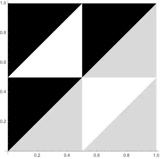

The answer is 75%. It can be evaluated via $$ 2 \int_0^1 \int_0^y \begin{cases} 1, &\text{if } \max\{x,y-x,1-y\} > \frac12 \\ 0, &\text{if } \max\{x,y-x,1-y\} \le \frac12 \end{cases} \bigg\} \,dx \,dy $$ (where we use symmetry to declare $x$ the left cut point and $y$ the right cut point).
In the graph below, the black triangles are the points $(x,y)$ from the integral above that satisfy $\max\{x,y-x,1-y\} > \frac12$ (and the light gray triangles are their symmetric twins $(y,x)$), while the white triangles are the points that satisfy $\max\{x,y-x,1-y\} \le \frac12$.
