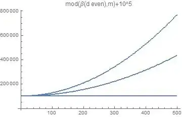

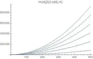

We can analyse the structure of this sequence by plotting it.
For even d we get
and for odd d
We see that there are "hidden" sub-sequences. Specifically, three and six sub-sequences for even and odd d, respectively.
Closer inspection shows that we have explicit formulas for the sequences as follows
$\beta(d \text{ even))}\equiv_{m} \left\{ \begin{array}{ll} \frac{d}{6} & \;\; d \equiv_{6} 0\\ 12 \left(\frac{d-2}{6}\right)^2+\frac{9 (d-2)}{6}+2 & \;\; d \equiv_{6} 2\\ 24 \left(\frac{d-4}{6}\right)^2+\frac{33 (d-4)}{6}+12 & \;\; d \equiv_{6} 4\\ \end{array} \right. \tag{14b}$
$\beta(d \text{ odd))}\equiv_{m} \left\{ \begin{array}{ll} 132 \left(\frac{d-1}{12}\right)^2+\frac{24 (d-1)}{12}+2 & \;\; d \equiv_{12} 1\\ 108 \left(\frac{d-3}{12}\right)^2+\frac{56 (d-3)}{12}+8 & \;\; d \equiv_{12} 3\\ 84 \left(\frac{d+7}{12}\right)^2-\frac{96 (d+7)}{12}+28 & \;\; d \equiv_{12} 5\\ 60 \left(\frac{d+5}{12}\right)^2-\frac{48 (d+5)}{12}+10 & \;\; d \equiv_{12} 7\\ 36 \left(\frac{d+3}{12}\right)^2-\frac{16 (d+3)}{12}+2 & \;\; d \equiv_{12} 9\\ 12 \left(\frac{d+1}{12}\right)^2 & \;\; d \equiv_{12} 11\\ \end{array} \right. \tag{14c}$
