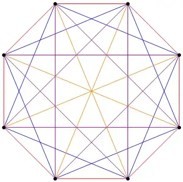

$k=4$ is a bit too small to visualize, so here is a picture for $k=8$:
Imagine that we are looking at a permutation $\sigma$ that permutes these $8$ vertices in a cycle, and we want a graph fixed by this permutation. (Maybe there are also other vertices we're not looking at, because we don't care what they do for the moment.) Then:
  • The $8$ red edges are an orbit of the action of $\sigma$ on $E(K_n)$. (They are either all present or all absent, if we want $\sigma$ to leave the graph unchanged.)
  • The $8$ blue edges are another orbit.
  • The $8$ purple edges are a third orbit.
  • The $4$ orange edges are a fourth orbit.
Essentially, if you rotate the picture above by $45^\circ$, then each edge is moved to another edge of the same color.
In general, there are $\lfloor \frac k2\rfloor$ orbits characterized by the length of an edge, when we draw the vertices in the cycle as a regular $k$-gon.
