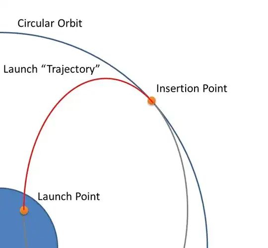

I'm trying to automate creation of a curve in PowerPoint.
Here's an image of what I'm working towards: enter image description here
I'm trying to show a diagram of a rocket trajectory from a launch site on Earth to a circular orbit. The math that I can't figure out is how to solve for an ellipse that connects the launch point (x1, y1) to the orbit insertion point (x2, y2) and is tangent to a vertical line at the launch point and tangent to the circular orbit. My approach has been to use (x-h)^2/a^2 + y^2 / b^2 = 1 because while I can set the horizontal axis of the ellipse at y=0, I don't know where the x coordinate of the center might fall, so I have an x-offset, h. I found an equation for the slope of a tangent line to an ellipse at a point as m = a^2*x/(b^2*y). I'm not sure if this is the right equation because sometimes the desired ellipse is longer horizontally and sometimes it might be longer vertically. If my insertion point is 45 degrees along the 1st quadrant of the orbit, then the tangent line has a slope of m = -1. Substituting the coordinates of the insertion point in to the slope equation, I can establish a relationship between a and b. Then I solved the ellipse equation for h as a function of x, y, and a (substituting for b with the slope relationship). Then I got 2 "h" equations by substituting the launch point, (x1, y1) and the insertion point, (x2, y2). Then I iterated to find an "a" value that minimized the difference between the 2 "h" equations. This successfully generated an ellipse that intersected the two points, but I think the slope at the insertion point is wrong (doesn't match the orbit), and it only appears to work for ellipses that are longer horizontally.

  • I think this is a duplicate of this previous question. There are infinitely many ellipses through two points with prescribed tangents, as described in my answer. –  May 16 '13 at 23:29
  • If you really want it to be an orbit, the ellipse and the circle should have a common focus, which doesn't seem to be a condition in the previous question. On the other hand, it also doesn't seem to be the case in your example picture... – Micah May 17 '13 at 02:11
  • Micah - yeah you're right - if this was a true orbital mechanics trajectory then there's a whole different set of rules to follow. Ironically, obtaining the actual trajectory for a launch vehicle to an orbit is the "easy" part for me because we have 3-DOF and 6-DOF trajectory codes for that purpose. What I want to create here is an automated notional diagram of a launch trajectory in which the launch site, number of stages (indicated with different colors along the trajectory), and orbit altitude can be changed. I'm tired of nudging shapes around in PowerPoint. – flutefreak7 May 17 '13 at 15:41
There is an equation for the circle $$x^2+y^2=1\tag{1}$$ (and if you desire a bigger radius, scale everything up once this is finished.) and at any point along it, $$2x+2yy'=0\tag{2}$$ Then there is an equation for the ellipse $$\frac{(x-h)^2}{a^2}+\frac{y^2}{b^2}=1\tag{3}$$ and at every point along it $$\frac{2(x-h)}{a^2}+\frac{2yy'}{b^2}=0\tag{4}$$
Your aim is to find $a,b$, and $h$ that provide the desired tangency. Let's call the point of tangency $(s,t)$. Then you have a system of three equations: $$\begin{align} s^2+t^2&=1\tag{1b}\\ a^2s&=b^2(s-h)\tag{2b}\\ \frac{(s-h)^2}{a^2}+\frac{t^2}{b^2}&=1\tag{3b} \end{align}$$ where (2b) equation has come from eliminating $yy'$ in equations (2) and (4). This is five unknowns in three equations, so the system is likely very underdetermined. You can throw in a fourth equation by specifying the coordinates of the launch point $$\frac{(x_0-h)^2}{a^2}=1\tag{4b}$$ but it makes sense that there will still remain one degree of freedom, when you think about elongating the ellipse vertically while contracting it horizontally and maintaining the tangency. So your task is to solve the system $$\begin{align} s^2+t^2&=1\tag{A}\\ a^2s&=b^2(s-h)\tag{B}\\ \frac{(s-h)^2}{a^2}+\frac{t^2}{b^2}&=1\tag{C}\\ \frac{(x_0-h)^2}{a^2}&=1\tag{D} \end{align}$$
I would use (B) to isolate $h$, and then substitute that into (C) and (D) and scale by $b^4$, resp $a^2b^4$: $$\begin{align} s^2+t^2&=1\tag{A}\\ a^2s^2+b^2{t^2}&=b^4\tag{C'}\\ (b^2x_0+a^2s-b^2s)^2&=a^2b^4\tag{D'} \end{align}$$ (A) can be used to isolate $t^2$ and insert into (C'): $$\begin{align} a^2s^2+b^2-b^2s^2&=b^4\tag{C''}\\ (b^2x_0+a^2s-b^2s)^2&=a^2b^4\tag{D'} \end{align}$$ $a^2$ can be isolated in (C'') and substituted into (D'), after which we rescale to keep denominators away: $$\begin{align} (sx_0-1+b^2)^2&=-b^2+b^2s^2+b^4\tag{D''} \end{align}$$ This appears quartic in $b$, but once expanded, the $b^4$ terms cancel: $$\begin{align} (sx_0-1)^2+2sx_0b^2&=b^2(1+s^2)\tag{D'''} \end{align}$$
and you should be free to choose any $b$, solve for $s$ with the quadratic formula and work your way back to get the other values, or vice versa. You have specified an insertion point at 45 degrees, so that would make $s=\frac{1}{\sqrt{2}}$. If we put this in equation (D''') and solve for $b^2$ we have $$\begin{align} b^2&=\frac{(x_0-\sqrt{2})^2}{3-2\sqrt{2}x_0}\tag{E} \end{align}$$
