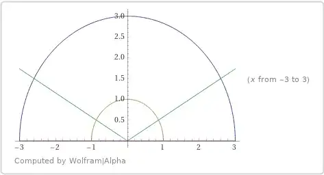

$$I=\int\limits_0^\infty\dfrac{\text dx}{1+x^6} =\dfrac12\int\limits_{-\infty}^\infty f(x)\,\text dx,$$ where $\,f(x)=\dfrac{1}{1+x^6}\,$ is the even function.
Let us consider the closed contour $\,\Gamma=L+C,\,$ where $\,L\,$ is the interval $\,[-R,R]\,$ (purple line) and $\,C\,$ is the half-circle with the radius $\,R>1,\,$ considered by increasing of polar angle $\,\varphi\,$ from $\,0\,$ to $\,\pi\,$ (blue line).
Integration contour
The function $\,f(z),\;z\in\mathbb C,\,$ has six poles, which can be founded from the equation $\,z^6=-1=e^{i\pi}.\,$ Assuming a polar notation $\,z=\rho e^{i\varphi},\;\rho\in(0,\infty),\;\varphi\in[0,2\pi),\,$ easily to get $$\rho^6=1,\quad 6\varphi =\pi+2\pi k,\quad k\in\mathbb Z,$$ with the set of solutions $$\rho=1,\;\varphi\in\left\{\dfrac{\pi}6, \dfrac{\pi}2, \dfrac{5\pi}6, \dfrac{7\pi}6, \dfrac{3\pi}2, \dfrac{11\pi}6\right\},$$ $$z\in\left\{\dfrac{\sqrt3}2+\dfrac12i, i, -\dfrac{\sqrt3}2+\dfrac12i, -\dfrac{\sqrt3}2-\dfrac12i, -i, \dfrac{\sqrt3}2-\dfrac12i\right\},$$ wherein the poles $$z_0=e^{i\,\large^\pi/_6}=\dfrac{\sqrt3}2+\dfrac12i,\quad z_1=e^{i\,\large^\pi/_2}=i,\quad z_2=e^{i\,\large^{5\pi}/_6}=-\dfrac{\sqrt3}2+\dfrac12i$$ belong to the inner part of the contour $\,\Gamma.\,$ Since the poles $\,z_0,z_1,z_2\,$ are simple and the contour $\,\Gamma\,$ does not contain additional singularities, then for arbitrary $\,R\in(1,\infty)\,$ $$J(R)=\oint\limits_\Gamma f(z)\text dz =2\pi i\sum\limits_{j=0,1,2}\underset{z_j}{\text{Res}}\,\dfrac1{1+z^6} =2\pi i\sum\limits_{j=0,1,2}\lim\limits_{z\to z_j}\,\dfrac1{6z^5} =\dfrac\pi3 i\sum\limits_{j=0,1,2}\dfrac {z_j}{z_j^6},$$ $$J(R)=-\dfrac\pi3 i\sum\limits_{j=0,1,2}z_j =-\dfrac\pi3 i\left(\dfrac{\sqrt3}2+\dfrac12i+i-\dfrac{\sqrt3}2+\dfrac12i\right)=\dfrac23\pi.$$ On the other hand, $$J(R)=\int\limits_{-R}^R f(x)\,\text dx + iR\int\limits_0^\pi f(Re^{i\varphi})e^{i\varphi}\,\text d\varphi,$$ wherein $$\lim\limits_{R\to\infty}\left|iR\int\limits_0^\pi f(Re^{i\varphi})e^{i\varphi}\,\text d\varphi\right| \leq \lim\limits_{R\to\infty}\pi\dfrac R{R^6-1}=0,$$ $$J(\infty)=2I,$$ $$\color{green}{\mathbf{I=\dfrac\pi3.}}$$
