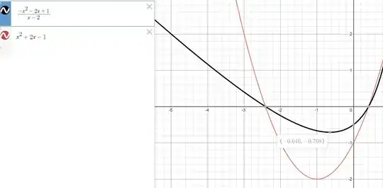

So I just waneted to ask - am I missing something? Is it possible to make here $x_{1+n} - x_{n} = \frac{-x_{n}^2-2x_n+1}{2 + x_{n}}$ an equality with $0$ and analyse simpler function (red one on the picture)?
