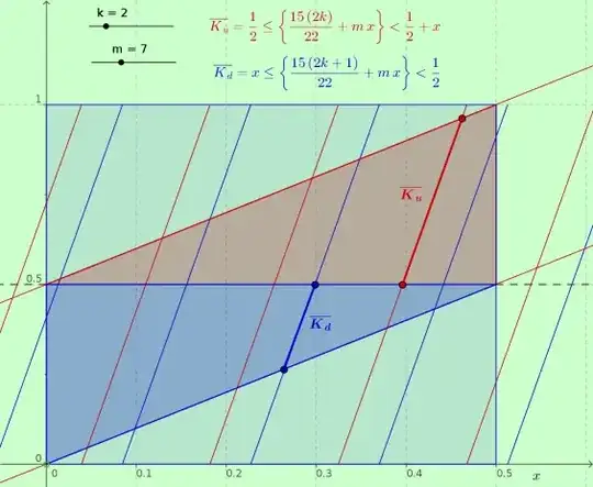

$\overline K (k,x)dx $ is represented by the segments of the two sawtooth waves intercepted
inside the respective forbidden areas like those shown in the following sketch. lanc_orol_2
Note that for better clarity the inclination $m$ of the lines is much lower than $719/11$.
The integral translate into the sum of the $\Delta x$ of each segment.

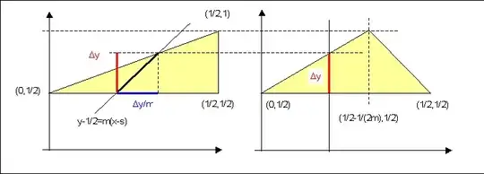

To compute them let's start with computing the intercepts with $y=1/2$.
The minimum intercept $s_{\,0}$ will be $$ \eqalign{ & y = \left\{ {q + m\,x} \right\} = \left\{ {\left\{ q \right\} + m\,x} \right\} = {1 \over 2}\quad \Rightarrow \cr & \Rightarrow \quad \left\{ q \right\} + m\,x = n + {1 \over 2}\quad \Rightarrow \cr & \Rightarrow \quad m\,x = n - \left( {\left\{ q \right\} - {1 \over 2}} \right) \cr & \Rightarrow \quad m \, s_{\,0} = \left\lceil {\left\{ q \right\} - {1 \over 2}} \right\rceil - \left( {\left\{ q \right\} - {1 \over 2}} \right) = \left( {{1 \over 2} - \left\{ q \right\}} \right) - \left\lfloor {{1 \over 2} - \left\{ q \right\}} \right\rfloor = \cr & = \left\{ {{1 \over 2} - q} \right\} \cr} $$ For the lower triangle we can simply replace $q$ with the negative of the intercept with $x=1/2$ , i.e.: $$ m\,s_{\,0} = \left\{ {{1 \over 2} + {m \over 2} + q} \right\} $$
Next we take the upper triangle and slant it as shown lanc_orol_3
where $$ \Delta y(x) = \left\{ {\matrix{ {{m \over {m - 1}}x} & {\left| {\;0 \le x < {1 \over 2}\left( {1 - {1 \over m}} \right)} \right.} \cr {m\left( {{1 \over 2} - x} \right)} & {\left| {\;{1 \over 2}\left( {1 - {1 \over m}} \right) \le x < {1 \over 2}} \right.} \cr } } \right. $$ so that we will compute $\Delta x$ as $ 1/m \, \Delta y$.
Finally, we are sampling the slanted triangle at points starting from $s_{\, 0}$ (which depends on $q$ and thus on $k$) and progressing with $\Delta s = 1/m$. $$ s(k,j) = s_{\,0} + {j \over m} = \left\{ {\matrix{ \matrix{ {1 \over m}\left\{ {{1 \over 2} - q} \right\} + {j \over m} = {{11} \over {719}}\left( {\left\{ {{1 \over 2} - {{15\left( {2k} \right)} \over {22}}} \right\} + j} \right) = \hfill \cr = {{11} \over {719}}\left( {\left\{ {{{11 - 8k} \over {22}}} \right\} + j} \right) = s_{\,u} (k,j) \hfill \cr} \hfill & {{\rm upper}\;{\rm Tr}{\rm .}} \hfill \cr \matrix{ {1 \over m}\left\{ {{1 \over 2} + {m \over 2} + q} \right\} + {j \over m} = {{11} \over {719}}\left( {\left\{ {{1 \over 2} + {{719} \over {22}} + {{15\left( {2k + 1} \right)} \over {22}}} \right\} + j} \right) = \hfill \cr = {{11} \over {719}}\left( {\left\{ {{{19 + 8k} \over {22}}} \right\} + j} \right) = s_{\,d} (k,j) \hfill \cr} \hfill & {{\rm lower}\;{\rm Tr}{\rm .}} \hfill \cr } } \right. $$
