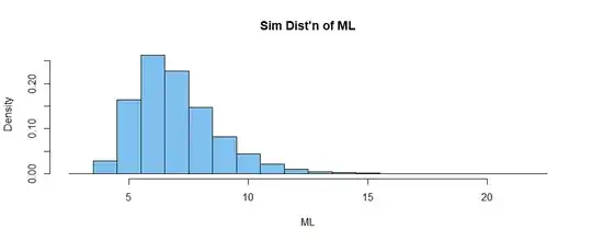

This is not the best forum for details about programming in a specific language. If you did a simulation in Python, you should not expect simulation results to match exact results from combinatorics.
In R, the procedure rle (for Run Length Encoding) shows the number and length of runs in a sequence x of results. For example, here is one way to find the length of the longest run of either 0s (say Tails) and 1a (say Heads) among (a particular) 20 tosses of a fair coin. In this example the answer is six.

If I repeat this procdure many times, I can get a good idea of the distribution of the length ML of longest run among 100 tosses, and thus of its mean. The answer is $7.975 \pm 0.011.$ With $m = 10^5$ iterations one can expect about two place accuracy. (With $m = 10^6$ I got $6.978\pm 0.004.)$

hist(ML, prob=T, br=(2:22)+.5, col="skyblue2", main="Sim Dist'n of ML")
I suppose analogous procedures are available in Plython. You seem to have good links for analytic solutions.

  • Thank you so much for the response @BruceET ! I guess I didn't word my question properly (not an English native speaker). My real question is "What is the probability of at least a 6-streak (doesn't matter whether it's HHHHHH or TTTTTT) appearing in a 100 coin tosses? Assume the experiment is repeated ten thousand times". Anyway, I tweaked some lines in my code to match your answer and I think my generated graph is pretty much the same as yours. – yfr Nov 22 '20 at 06:52
