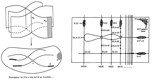

There is a strong conceptual reason to study the prime ideals of a ring: in algebraic geometry, we can study / think about a ring $R$ using an associated geometric object called $\mathrm{Spec}(R)$, the points of which are precisely the prime ideals of $R$. This idea is one of the many Grothendieck introduced, ushering in "modern" algebraic geometry.
(on the left: the frontispiece of Reid's Undergraduate Commutative Algebra)
(on the right: Mumford's famous sketch of $\mathrm{Spec}(\mathbb{Z}[x])$; note that $\mathbb{Z}[x]$ is not Dedekind.)
However, I don't have enough time at the moment to give a detailed explanation of the above; I'm sure someone else will be able to. But just to offer a perhaps more mundane answer: there are many properties $\mathsf{X}$ that an arbitrary commutative ring might have that are local, in the sense that $$R\text{ has property }\mathsf{X}\iff R_P\text{ has property }\mathsf{X}\text{ for all prime ideals }P\subset R,$$ where $R_P$ is the localization of the ring $R$ at the prime ideal $P$. The same is true for arbitrary modules over arbitrary commutative rings; that is, if $M$ is a module over $R$, then there are many module properties $\mathsf{Y}$ for which $$M\text{ has property }\mathsf{Y}\iff M_P\text{ has property }\mathsf{Y}\text{ for all prime ideals }P\subset R.$$
