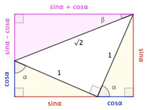

If $$\tan\beta=\frac{\sin\alpha-\cos\alpha}{\sin\alpha+\cos\alpha}$$ then prove that $$\sqrt2\sin\beta=\sin\alpha-\cos\alpha$$

You can use the fact that $$ \sin^2\beta=\frac{\sin^2\beta}{\cos^2\beta+\sin^2\beta}=\frac{\tan^2\beta}{1+\tan^2\beta} $$ and this will show that $$ \sin^2\beta=\frac{(\sin\alpha-\cos\alpha)^2}{2}\tag{*} $$ On the other hand, the statement is generally false. Take $\alpha=\pi/3$ and $\beta=\pi+\arctan(2-\sqrt{3})$, after having observed that $$ \frac{\sin\alpha-\cos\alpha}{\sin\alpha+\cos\alpha}=2-\sqrt{3} $$ Then $\sin\beta<0$, but $\sin\alpha-\cos\alpha>0$.
Therefore (*) is the best you can prove.

$$\tan\beta=\dfrac{1-\tan\alpha}{1+\tan\alpha}=\tan(\pi/4-\alpha)$$
$$\beta=n\pi+\pi/4-\alpha$$ where $n$ is any integer
$$\implies\sin\beta=\sin(n\pi+\pi/4-\alpha)$$
Now as $\sin(n\pi+x)=(-1)^n\sin x,$
$$\sin\beta=(-1)^n\sin(\pi/4-\alpha)=?$$
