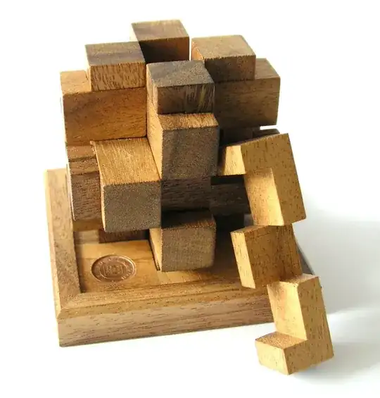

Using Buckingham $\Pi$ theorem is like working a mechanical puzzle: enter image description here (Source: https://en.wikipedia.org/wiki/Mechanical_puzzle)
You employ all your backgrounds (intuition + ...) to solve it.
