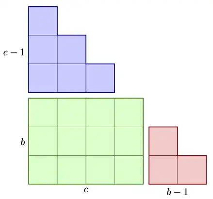

Here’s a visual proof, to complement the algebra of other answers:
When you start the game (from 20), draw a “staircase” shape like in the figure, but with 19 squares in the base (so also 19 squares high). As you play, for each number on the board you’ll always have a corresponding staircase, with base and height 1 less than that number. Each turn, when you split up a number as $n = b+c$, split up its staircase as shown in the picture; that gives you a $b \times c$ rectangle, plus two smaller staircases for the resulting numbers $b$ and $c$. The area of the rectangles is your score so far. When all the numbers left are 1’s, then you’ve converted the whole original staircase into rectangles — so your final score is the total area of the original staircase.
This area, the number of squares in the staircase of base $n-1$, is given by the formula $\frac{n(n-1)}{2}$, as noted in other answers. This is a famous formula, and if you haven’t seen it before, it can be explained by the fact that two such staircases fit together into an $n \times (n-1)$ rectangle.
