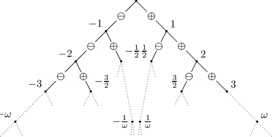

I also felt that this was wrong too though, because the surreal numbers are a way to make that chain of real numbers. Surreal tree You could take the surreal numbers at a specific day start at the far left, and then order each item as you move to the right. Or, it seems like you could step-by-step/recursively insert real numbers into a set to get the ordered chain of real numbers by inserting the real numbers so that to the left are numbers less and numbers to the right are greater.
