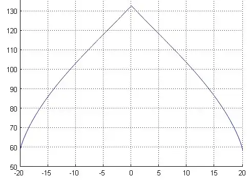

Using DFT, I have obtained the following ogival curve for this Fourier transform (code below); I will continue to work on this question ...
Matlab code:
x=-20:0.011:20;
c=1; % other values give almost the same shape
s=1./abs(x-c);u=fftshift(abs(fft(s)));
s=1./abs(x+c);v=fftshift(abs(fft(s)));
w=conv(u,v,'same');
plot(x,1e-7*w);

    @Maxim I recognize that I have some "holes" in my knowledge of distributions. Maybe, LL 3.14, could you answer ? – Jean Marie Oct 27 '20 at 16:33
