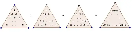

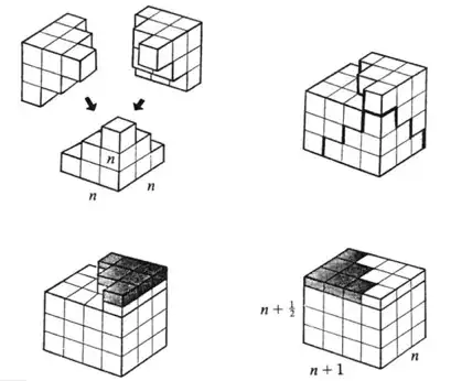

Here are some "proof without words"(I find them more elegant):
Sum of squares
Sum of Squares(2)
