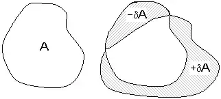

To complement Qiaochu Y. excellent explanation note that, same as we write $$ \eqalign{ & \int {f(x)dx} = g(x) = \int_{t = a}^x {f(t)dt} + c = \int\limits_{t \in \left[ {a,x} \right]} {f(t)dt} + c\quad \Rightarrow \quad \cr & \Rightarrow \quad d\int_{t = a}^x {f(t)dt} = \int\limits_{t \in \left[ {x,x + dx} \right]} {f(t)dt} = f(x)dx = {d \over {dx}}g(x)dx \cr} $$ with all cautions as for continuity, and with the algebraic meaning for negative $dx$,
then, specially in physics, we often write $$ \eqalign{ & \int\!\!\!\int\limits_A {f(x,y)dxdy} = \int\!\!\!\int\limits_A {f(x,y)\delta A} = g(A)\quad \Rightarrow \cr & \Rightarrow \quad \delta \int\!\!\!\int\limits_A {f(x,y)\delta A} = \int\!\!\!\int\limits_{\delta A} {f(x,y)dxdy} = {d \over {dA}}g(A)\,\delta A \cr} $$ where the $\delta A$ is also taken with the algebraic sign.
Delta_Int_Mult_1
From here we reach to Stoke's Theorem.
