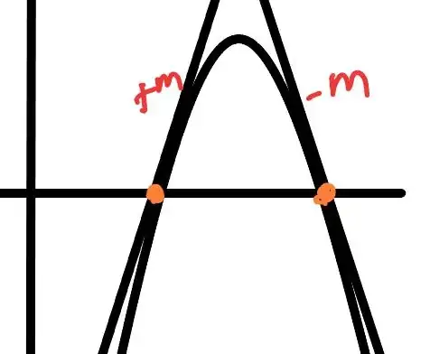

Geometric Interpretation
(courtesy of @TheSilverDoe's comment above)
The graph of $y = ax^2 + bx + c$ is a parabola whose axis of symmetry is the vertical line $x = \frac{r+s}{2},$ because the axis goes through the vertex and the vertex is (horizontally) midway between the two $x$-intercepts. Thus, the slopes (= steepness) at the intercepts (which are equi-distant from the axis) have equal magnitudes with opposite signs. It will help to draw a rough diagram. If the parabola opens upward, then the slope at the left intercept has a certain negative value, the slope at the right intercept has a certain positive value, and these two values have the same magnitude -- think about reflecting the left side of the parabola about the axis of symmetry to get the right side of the parabola. The situation is similar when the parabola opens downward.

If someone wants to include a diagram for the geometric interpretation, please go ahead. I'm not sure how to do this, and I don't really have time now anyway --- I'm busy with "day job" stuff that I temporarily put aside while writing this answer. – Dave L. Renfro Oct 19 '20 at 17:45
