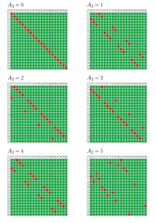

    The following image visualizes the output of the program for all initial configuration with $0\leq A_1,A_2\leq20$ and $0\leq A_3\leq5$ ($A_j=0$ for $j\geq4$, $A_0$ is irrelevant). If a cell of the table is green, the first player wins this game configuration. If it's red, the second player wins.
    Visualization of game configurations
    As you can see, there is a clear pattern for $0\leq A_3\leq4$. But for $A_3=5$, I cannot make out any order. It looks quite chaotic to me. If you go higher than $A_3=5$, it's even more chaotic.

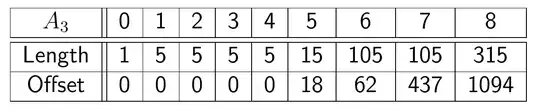

The following table shows the lengths of the repeating pattern and the number of terms before it starts (offset) for different $A_3$:
Table of pattern length and offset
The pattern length and the offset seem to grow as $A_3$ gets larger. You can also notice that the pattern length for $A_3=j$ is an integer multiple of the pattern length for $A_3=j-1$. I can't make out a similar pattern for the offset values.
The values within a repeating pattern for $A_3\geq5$ seem very random to me. The pattern for $A_3=5$ $(7,8,-6,-6,-4,3,7,-8,-7,-4,7,7,-6,6,-4)$ doesn't look like it has any order. It would be nice to have a formula for predicting the pattern for a given $A_3$.

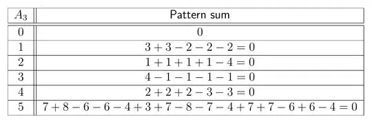

Upon closer inspection, I realized something: If you look at the sum of all numbers within a pattern for some $A_3$, you will get $0$.
Table of pattern sums
I have checked this property for $A_3\leq8$, but I believe that it holds for all $A_3$.
This gives me some hope for finding a formula for the values of a pattern. They may not be that random after all.

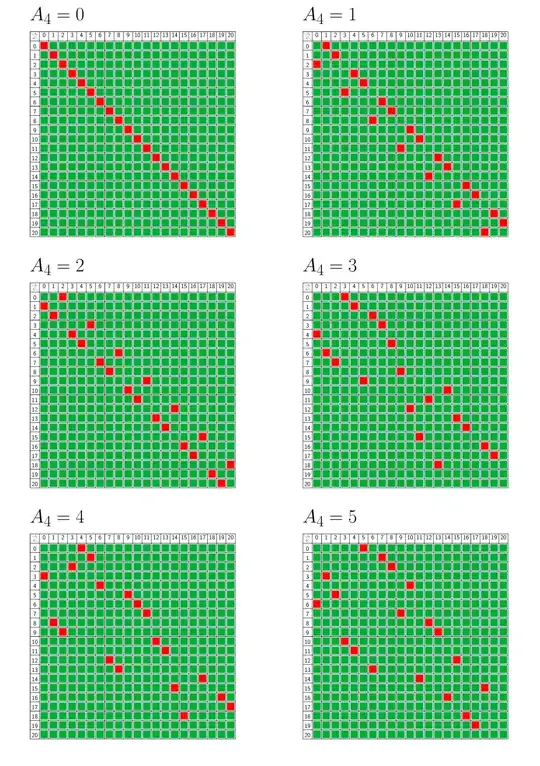

The following image visualizes the losing states of $S_2$ for all initial configurations with $0\leq A_1,A_2\leq20$ and $0\leq A_4\leq5$ ($A_j=0$ for $j\geq5$, $A_0$ and $A_3$ are irrelevant). The losing states are colored red.
Visualization of losing states
You can see a pattern for $0\leq A_4\leq2$, but for $A_4\geq3$ the chaos takes over again. I really hoped for something more regular. I thought that analyzing $S_2$ might help to solve $S_\infty$, but right now it doesn't look like it. Anyway, I will do further analysis of $S_2$ in another update.

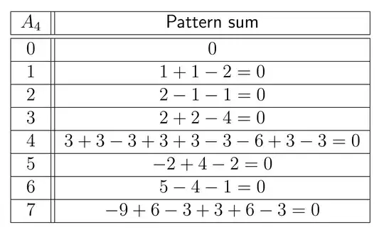

If you add the values of a particular pattern together, you again get $0$:
I think that there is such an infinitely repeating pattern with sum $0$ for any $A_4$, but (of course) I can't prove it.
