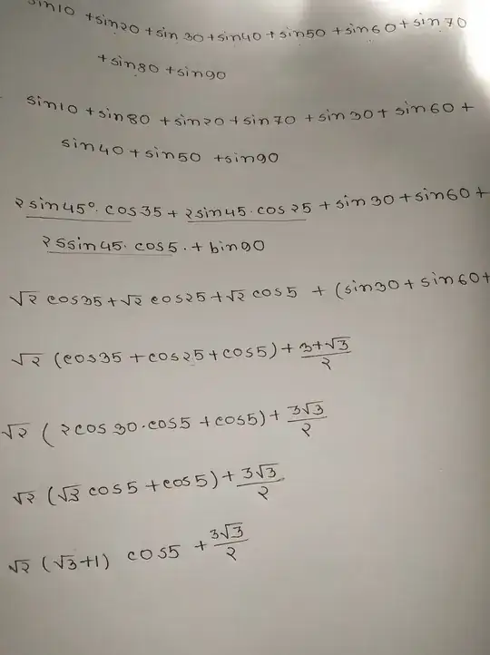

The question is finding $$S = \sin 10^\circ + \sin 20^\circ + \sin 30^\circ + \cdots +\sin 90^\circ$$
I tried to do it, but I can't eliminate the $\cos 5^\circ$.
Can anyone help me with the answer?
Best it is to follow symbolic derivation of sums of sine of $n$ angles in A.P, of common difference $\beta= 10^{\circ}.$ And then apply it.
$$ S = \sin ( average\; angle)\cdot \dfrac{\sin n \beta/2}{\sin \beta/2}$$
$$={ \sin 50^{\circ}}\dfrac{ \sin 9\times 5^{\circ}}{\sin 5^{\circ}}.$$
