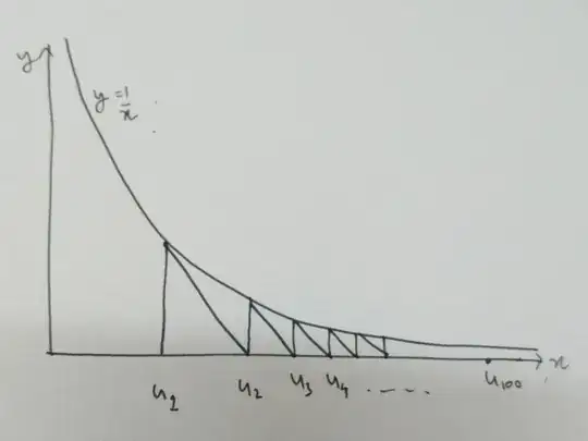

So far I've been able to see a pattern on $y = 1/x$ graph: start on $(1, 1)$ go down diagonally along $x+y=0$, hit x-axis and go straight up, hit the curve and keep repeating these right triangles. Not sure if this helps but I'm not able to proceed any further. enter image description here
