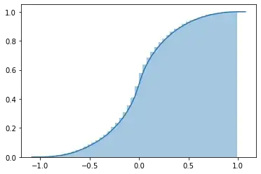

Changing the sampling interval to $(-1, +1)$ makes things a bit difficult from the theoretical perspective. Experimentally, it is rather simple. This is the code I wrote to simulate the experiment for $\mathcal{U}(0,1)$. Changing it from (0, theta) to (-1, +1) gives me an average probability of $62.7\%$ with a standard deviation of $0.3\%$
I plotted the simulated PDF and CDF. In that order, they are:
PDFCDF
So I'm aiming to find a CDF that looks like the second image.
