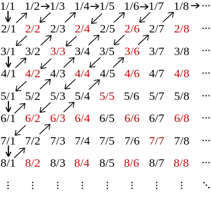

and then do the diagonalization thing that Cantor used to prove the rational numbers are countable: enter image description here
Why wouldn't this work?

  • @Vikise Note that, with respect to the argument used to show that the rationals are countable, if you give me a rational number, I can produce the index at which that number appears (though it might take some time to figure it out, I can, in principle, do it). So, pick any infinite subset of $\mathbb{N}$. My favorite infinite subset is the set ${2,4,6,8,10,\dotsc}$. What is the index of that set? – Xander Henderson Sep 03 '20 at 11:55

  • In the argument showing that the rationals are countable, every rational appears in the array at some coordinate: row $m$, column $n$, for finite $m$ and $n$. But in your arrangement of subsets of $\mathbb{N}$ in an array, any set appearing in row $m$ column $n$, for some finite $m$, $n$, is a finite subset of $\mathbb{N}$. So in order to include infinite subsets using this same scheme, you'd need to add even more rows and columns to the array. And you won't be able to do it in a way that keeps only countably many coordinates in the resulting array. – halrankard2 Sep 03 '20 at 12:01

  • Yes that's right. Or at least you'd need to give a concrete description of what kind of indexing scheme you are using (in analogy to using an $\mathbb{N}\times\mathbb{N}$ grid to index the rationals). Once you do that, however, you'll find that no indexing scheme big enough to capture all subsets of $\mathbb{N}$ can be countable. – halrankard2 Sep 03 '20 at 12:11
