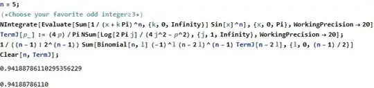

Addendum. Here is a Mathematica code for numerical verification of $\text{(1)}$:
n = 5; (* Choose your favorite odd integer >= 3*)
NIntegrate[Evaluate[Sum[1/(x + k Pi)^n, {k, 0, Infinity}] Sin[x]^n], {x, 0, Pi}, WorkingPrecision -> 20]
TermJ[p_] := (4 p)/Pi NSum[Log[2 Pi j]/(4 j^2 - p^2), {j, 1, Infinity}, WorkingPrecision -> 20];
1/((n - 1)! 2^(n - 1)) Sum[Binomial[n, l] (-1)^l (n - 2 l)^(n - 1) TermJ[n - 2 l], {l, 0, (n - 1)/2}]
Clear[n, TermJ];
Numerical verification
