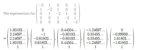

Example:
As an example (like the one in the question linked above), say that two matrices commute. Commuting matrices share eigenvectors. However, the eigenvectors of one matrix are real, while the eigenvectors of the other are complex.
As a different example, consider a circulant $C$ matrix, formed via a linear combination of the single row permutation matrix $P$.
$P=\left[\begin{array}{llll}0 & 1 & 0 & 0 \\ 0 & 0 & 1 & 0 \\ 0 & 0 & 0 & 1 \\ 1 & 0 & 0 & 0\end{array}\right]$
$C=\left[\begin{array}{llll}c_{0} & c_{1} & c_{2} & c_{3} \\ c_{3} & c_{0} & c_{1} & c_{2} \\ c_{2} & c_{3} & c_{0} & c_{1} \\ c_{1} & c_{2} & c_{3} & c_{0}\end{array}\right]$
$C=c_{0} P^{0}+c_{1} P^{1}+c_{2} P^{2}+c_{3} P^{3}$
From that last equation, we can see that they would share eigenvectors. However, as shown in the linked question, its possible that $C$ has real eigenvectors, while $P$ has complex ones.
(And then the eigenvectors of the permutation matrix hold the roots of unity, which is explained in this pdf linked here: http://perrylocal.org/meinkea/files/2010/10/Circulant-Matrices.pdf)
