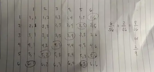

What's the probability of getting a total of $7$ or $11$ when a pair of fair dice is tossed?
I already looked it up on the internet and my answer matched the same answer on a site. However, though I am confident that my solution is right, I am curious if there's a method in which I could compute this faster since the photo below shows how time consuming that kind of approach would be. Thanks in advance.

    You should be able to solve problems like that without paper in a few seconds. First, you know there are 36 different possible throws: 2 die each with 6 faces, gives 36 possible throws. There are only 2 ways to get 11: 6-5 and 5-6, along with 6 ways to get 7: 1-6, 6-1, 5-2, 2-5, 3-4, 4-3. 8 total ways to 7 or 11: 8/36 = 2/9 = 0.22222 – stretch Aug 14 '20 at 02:26
    Please do Not Post an Image of the formulas. Use Latex or Format This table as code – miracle173 Aug 14 '20 at 02:35

For $7$, see that the first roll doesn't matter. Why? If we roll anything from $1$ to $6$, then the second roll can always get a sum of $7$. The second dice has probability $\frac{1}{6}$ that it matches with the first roll.
Then, for $11$, I like to think of it as the probability of rolling a $3$. It's much easier. Why? Try inverting all the numbers in your die table you had in the image. Instead of $1, 2, 3, 4, 5, 6$, go $6, 5, 4, 3, 2, 1$. You should see that $11$ and $3$ overlap. From here, just calculate that there are $2$ ways to roll a $3$: either $1, 2$ or $2, 1$. So it's $\frac{2}{36} = \frac{1}{18}$.
