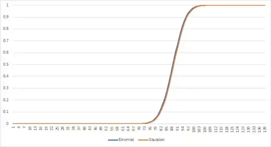

The confidence interval for the proportion is
$[p-z \sqrt{\frac{p(1-p)}{n}}, p+z \sqrt{\frac{p(1-p)}{n}}]$
Where $p$ is the sample proportion.
The distribution is a binomial law with estimated probability $p=\frac{88}{138}$. The confidence interval can be obtained as the $5\%$ and $95\%$ quantiles of the binomial distribution $B(n,p)$.
The Gaussian approximation is justified, though the upper limits differs by one unit (low limit in $[78,79]$, high limit in $[96,97]$ or $[97,98]$).
