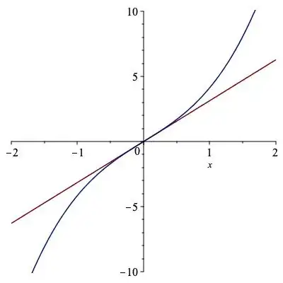

The construction First, choose your favorite irrational number, let's say $\pi$. Consider the two curves $\phi_1(x)=\pi x$ and $\phi_2(x) = \pi x + x^3$.
Of course, any function $f$ with graph between these two has $f'(0)=\pi$. Define such a function by using a sequence of rational "knots" $r_n \searrow 0$ and $A_n$ so that $$ \phi_1(r_n) < A_n < \phi_2(r_n) $$ Then fill in with the splines as explained, to get a function $f$ with $f(r_n) = A_n$ and $f'(r_n) = 0$ for all $n$. Do the same thing on the negative side. Finallly let $f(0)=0$.
This gives us $f : \mathbb R \to \mathbb R$ such that $f(\mathbb Q) \subseteq \mathbb Q$, $f$ is differentiable except possibly at $0$, and $$ \lim_n \frac{f(r_n)-f(0)}{r_n-0} = \pi $$ is irrational.
What remains: we need to choose the sequences $r_n$ and $A_n$ so that the rectangles with opposite vertices $(r_n,A_n)$ and $(r_{n+1},A_{n+1})$ lie entirely between $\phi_1$ and $\phi_2$. Then by Remark 1, $f$ remains between $\phi_1$ and $\phi_2$, so $f'(0)=\pi$.
