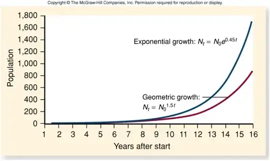

Update: I have found a diagram similar to the book in which I saw the concept. Geometric Vs exponential Source: https://cmapspublic3.ihmc.us/rid=1R0TPVNFG-113V4JS-1H9C/1R2CJ0126I1VCLY5MI1GHRIimage

  • Can I say that the 2 graphs are basically same, and one is just continuous and other is just discrete? If I can find that ecology book (certainly I have wrote its name and publisher some or some place) I will be further able to specify my question. –  Aug 03 '20 at 17:32
  • The book suggested 2 different graphs as I shown in the attachment. –  Aug 03 '20 at 17:33
    @AlwaysConfused The graph in attachment is different since they are different function. – banned Aug 03 '20 at 17:37
